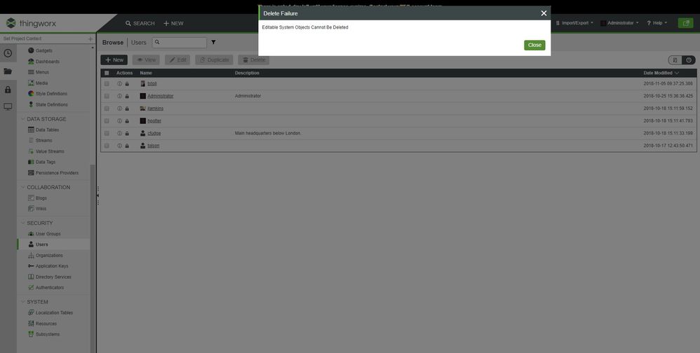

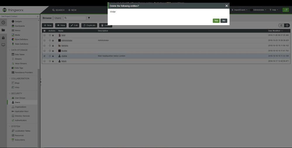

I was testing a service I wrote to allow users to create users using the CloneUserWithGroups() API.  When testing, I created a couple users while logged in as the Administrator.  That part worked fine.  My issue is: ThingWorx won't allow me to delete those users!!??
ThingWorx returned a Delete Failure error message saying, "Editable System Objects Cannot Be Deleted."
I've removed those users from the groups the Administrator is in, but I'm still getting the same error message.

Can you provide a screenshot of what you're attempting to delete?  Based on the error message you're getting, it sounds as if you are deleting system objects instead of the users you created.

I was able to reproduce the issue. What access level did you set up  as your input? It seems like the users were created as system objects.

Alright, just looked into the details of the one I reproduced.
Because you clone an Administrator user, it writes it as a systemobject (cloning all aspects).
I exported the user entity in xml format and manually edited the
aspect,isEditableSystemObject="false" (was set to true originally post creation)
Save the xml, import it back into the system-  now you can delete your user.

This works per design. If you are cloning a user, all aspects (including the system object Boolean) will be "cloned". This is different from creating a user and assigning it to the administrator group.
