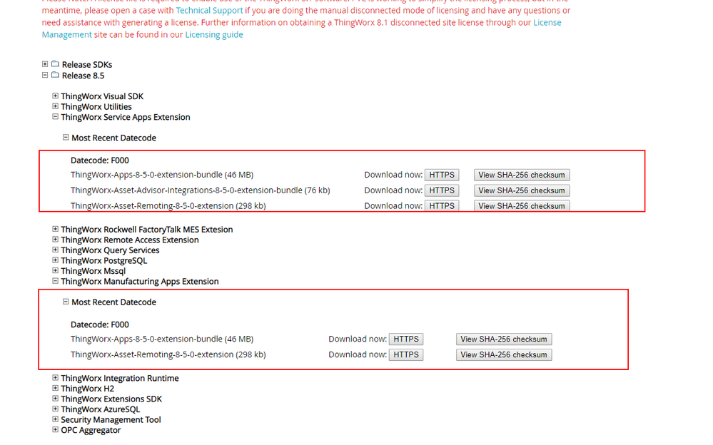

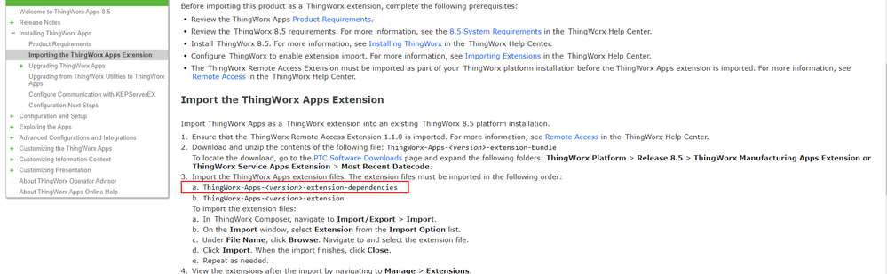

I'm trying to install the thingworx apps 8.5 , I need import "Cannot find ThingWorx-Apps-<version>-extension-dependencies " firstly according to the guide.  But I could not find it in whatever service apps or manufacturing apps in PTC Software Downloads.
Any suggestion ?

You need to unzip extension-bundle.zip. In that you can find dependencies extensions. First you need to install dependencies extension and then import Manufacturing app extension.
/VR
