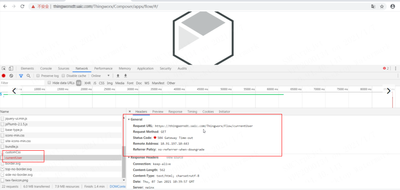

ThingFlow keep hanging when launching it , I've  checked the article https://www.ptc.com/en/support/article/CS323653
, but still doesn't help.   could be any other reason ?
ThingWorx 9.1.0
OS: REHL 8.2
Sean

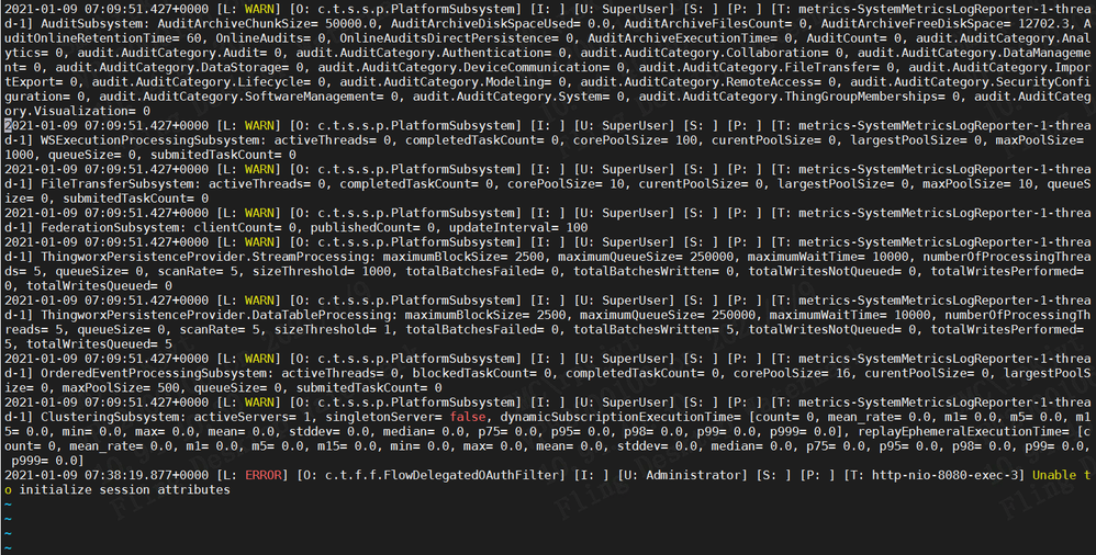

I've reviewed the steps you suggested , but still cannot launch flow .
I found more logs may related to the request: currentuser:
