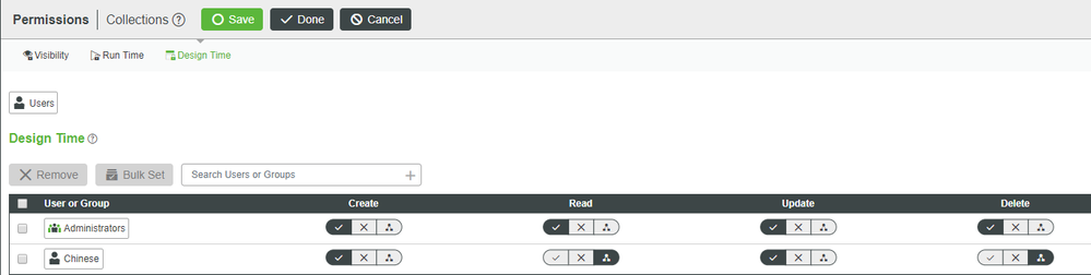

i.e. Only give this Manager User DesignTime permission for Create and Update in the Users Collection. (No Read, add Delete if needed)

Give abcAdmin user Create, Delete and Update in the Users Collection, let him create User accounts for all the members in his abc team, and then this user could manage all the Users he created.
Since this abcAdmin user doesn't have Read permission in the Collection, he won't be able to see the Users created by other accounts (i.e. users which belong to other teams), thus not able to edit or delete them.
