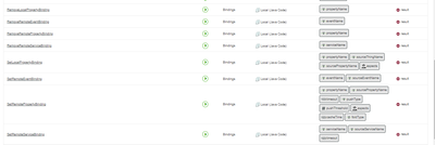

Hi @GV_11098078 ,
In thing level you can find the  'SetLocalPropertyBinding,SetRemotePropertyBinding,RemoveLocalPropertyBinding,RemoveRemotePropertyBinding'  with the help of these Binding Servcies  you can easily manage the bindings to property in script level.
