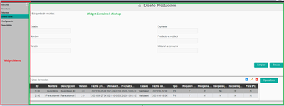

Hi, I have this Mashup (Always showed on the screen) the widget containedMashup (Green square) is the only one that changes:
I know how to change the contained mashup by binding the Menu (String Mashup property) to the Name of the contained Mashup as follows:
BUT, now I want to change the contained mashup when I click a Button inside the Contained Mashup. Is like one mashup goes after another one withotu click on the menu, just click a Button inside the Mashup.

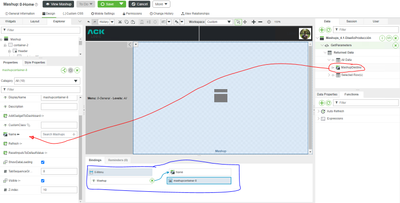

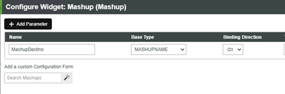

Another option I tried was to create a Mashup parameter on the Mashup which I have to click the button and try to send the target MashupName to the ContainedMashup property:
I Add the Mashup where I have the parameter created and using the service GetParameter I can get the parameter created on the mashup where I have the contained Mashup (red):
But the problem is that as The mashup name of the menu is already blinded, I can't bind this parameter because is like only accepts one input:
At this point I can do some Function expression with lots of inputs (names of destination mashups) and the result output will be String Mashup name and link it to the MashupName property of the contained mashup. The problem is when and how activate this Function and the GetParameter Service. I only want to update or execute that when the button of certain mashups is pressed or the menu changes.
