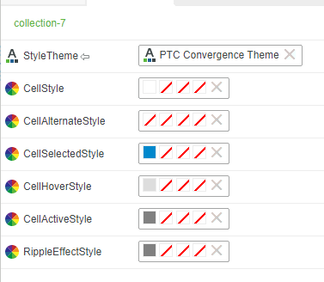

I am using a Collection widget, with the following styling:
But for some selected cell or hover styling, colouring is not working or is not showing up.
Thingworx version: 9.4

Try to make cell widget’s background transparent instead of white.

Not the solution I am looking for, I will keep this post open

Sorry, used a wrong word -- "Try to make cell mashup's background transparent instead of white."
Does that work?
