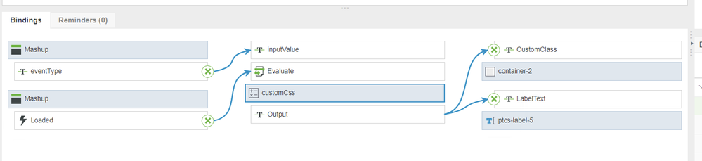

Step 2: Create expression function threshold value input
/* Condition based on your user case */
if(inputValue === "Alert")
  Output = "bgRed";
} else
  Output = "bgGreen";
Step 3: Bind the output of the expression to the container CustomClass property

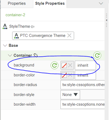

Step 4: Remove the existing background color from Container

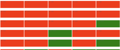

Now if you load the main mashup it will look like this
  Output = "bgRed";
} else
  Output = "bgGreen";
