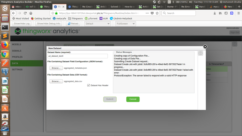

Hi @cmorfin,
Now I'm getting this error in Analytics Builder also.
Plz help...My application has stopped working now...

cmorfin
(To:ashu_shukla)
Hi
I was talking to the DevZone team but it appears that the hosted instances are not meant to be used with Analytics as there are some known issues.
Instead all the Analytics Quickstart Guides point to use the Analytics Trial Edition (ATE) that is downloadable from  https://developer.thingworx.com/resources/downloads .
I understand that it used to work but unfortunately there is no support from the DevZone team for the analytics component on the hosted instances.
So the best way forward for you is to download and install the ATE.
Hope this helps
Kind rgeards
Christophe
