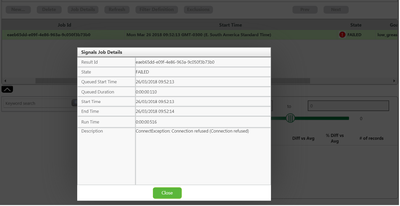

Hi,  I Am testing the Analytic Trial, I make the CSV and JSON download from the developer site (Build a Predictive Analytics Model - analytics_vibration -   https://developer.thingworx.com/resources/guides/analytics-builder-quickstart/data-upload) and created a datat set.
When I Try to create a Signal or a Profile, It return failed. Connetion Refused.
The ThingWorx is the Trial version and I Am Running on DockerMachinePTC.

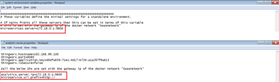

Hi Christophe,
I did the steps of the article. I put the port number (9800) in from of the IP.
After that I was able to create a signal and a profiler.
The connection problem is solved.
am having some issues yet, but now is related to the data and my Model stays in Running. But I am trying to fix it.
Thank You.
