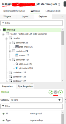

I'm currently using ThingWorx 9.1.8-b845 and I have a problem when I want to create a mashup parameters in a Master Mashup. The gear symbol is unclickable (see picture below). Does it mean that I can't create mashup parameters in a master mashup?

Masters do not support mashup parameters since they are intended to be used with multiple child mashups.
Depending on what you are trying todo, you can potentially use session parameters.
It is showing that you opened a Master vs. a Mashup.
