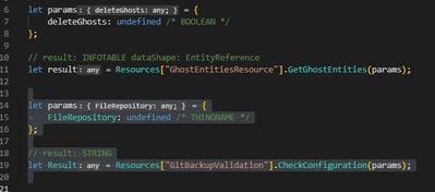

Now, this is fine and all. But I also noticed that both the GitBackup extension and the Ghost resource also have their own snippets:
They produce this code:
Now, perhaps I have misunderstood the functionality of this and that this functionality only provides standard code, such as the params json and function calls.
