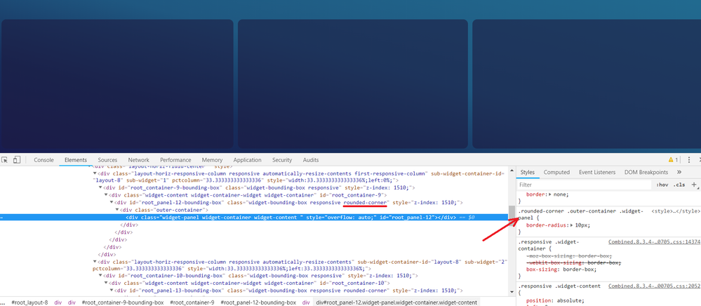

Strange issues while adding custom CSS to mashups which were made using the Legacy Composer.

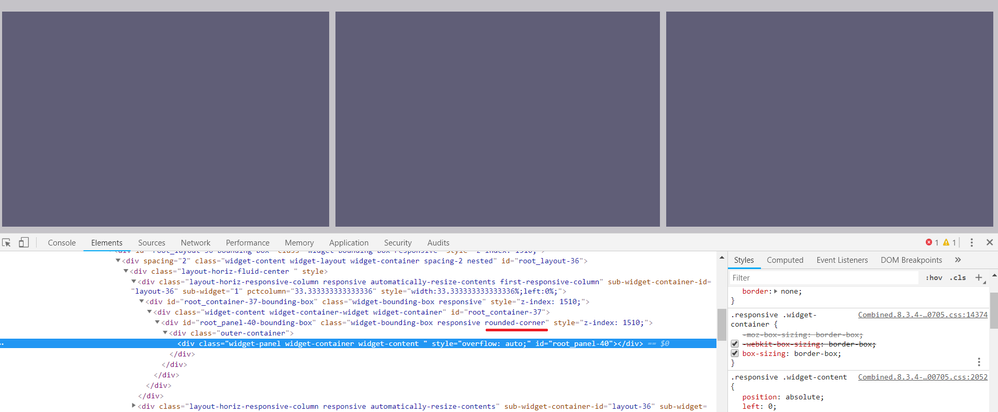

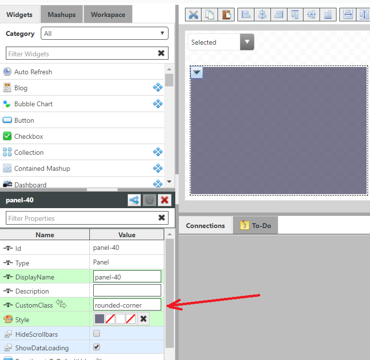

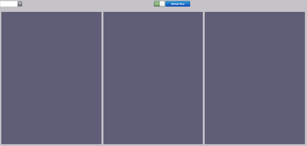

I tried to add some custom styling to some widgets inside a mashup that were actually authored using the Legacy Composer and later edited in the New Composer. Although the Custom Class gets added to the the widget top div, the styles does not gets attached.  But this completely works fine if the mashup is authored using
Scenario 1
Mashup authored in Legacy Composer and edited in New Composer.
Result: Custom class getting added but styles are not getting added. Hence the Mashup does not have the necessary styling.
CustomClass addedCustomClass addedCSS for the CustomClassCSS for the CustomClassmashupmashup
Class got added but styles did not. As a result panel does not show rounded cornerClass got added but styles did not. As a result panel does not show rounded corner

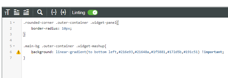

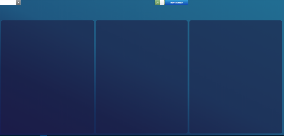

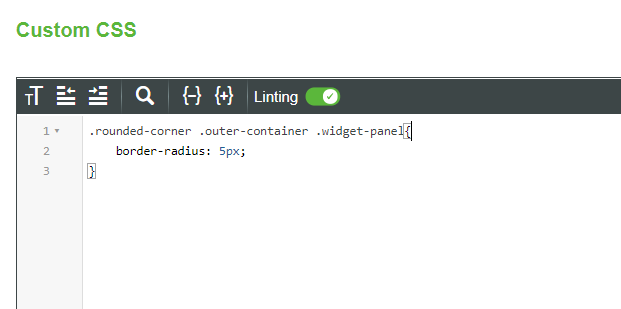

Scenario 2:
Mashup authored in New Composer and edited in New Composer.
Result: CustomClass getting added as well as the styles are getting added.
Custom CSS addedCustom CSS addedMashup with rounded corner Panels and background colorMashup with rounded corner Panels and background colorClass got added as well as the stylesClass got added as well as the styles
