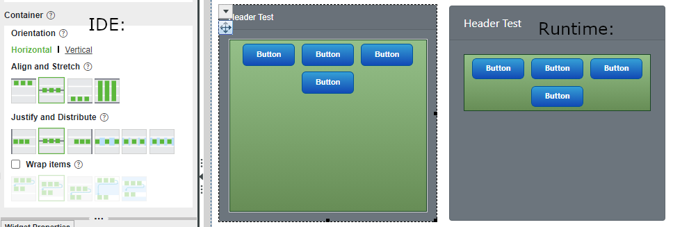

The result is looking quite nice:
The green box is the dynamicly created flexcontainer and all flexcontainer functions seem to work inside the MashupBuilder (eg. Wrap of Items, dividing by row&column, etc.). But currently the flexcontainer is only working well in the IDE, especially the size. In runtime the margins look little different and it does not automatically scale to the size of the card body Element. So still some work to do ...
So any idea & tips still welcome!
