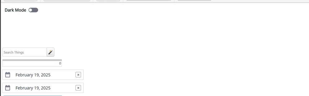

I wanted to achieve a Dark Mode and a Light Mode in my Dashboard.

Hi @Abhishek_Tirkey
You can achieve using Custom CSS
Example :
CSS Code to change background color
.darkMode{
    background-color : black !important
.lightMode{
    background-color : white !important
 Based on toggle button state pass custom CSS class name to container. By this way you can achieve dark or light mode
Expression :
if (toogle === true){
    Output = 'darkMode';
} else {
     Output = 'lightMode';
Bindings :
Result :
/VR

Hi, @Velkumar , Thanks for the response
I could not able to bind state with toggle
I am unable to locate toggle .
Abhishek Tirkey
@Abhishek_Tirkey  Have you created toggle input for your expression ?
I missed to take a toggle input.
Thank you @Velkumar . I have achieved to get the desired output.
