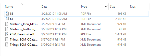

Hi Guys,
Is there any way to retrieve data from local file system???
Basically I want to show all the files and its meta information in a grid like the following image.
I want to display recently uploaded files from System Repository / other repository in the grid.
Can I get any suggestion for this?

Does anything prevent you from placing the files in a Thingworx File Repository?
If not, there are services and widgets to display that content.

Hi PaiChung ,
Do we have widgets to get file information to Thingworx?

Okay..,
I got it.
I created one thing with FileRepository as  thing template and
FileRepositoryHomeMashup as home mashup.
Now am getting much than I expected.
