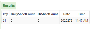

So what is your "Date" -- is it a STRING or DATETIME? If it's a STRING, can you provide few examples of what exactly is inside? In general, it would help if you post a screenshot of what you see when you execute QueryDataTableEntries().
It is a STRING currently.
This is my GetDate service.
Result after I run the service 'StoreHourlySheetCount' that you cleaned up for me.
