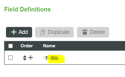

Does DataShape does not support property name having hypen?
Test_user
9-Granite
var result = Resources["InfoTableFunctions"].CreateInfoTableFromDataShape({
dataShapeName: "TestDataShape"
var newEntry=new Object();
for(var i=0;i<result1.length;i++){
newEntry.first-data = result1[i].first-data;
result.AddRow(newEntry);
Does DataShape does not support property name having hypen? ie.newEntry.first-data
and my second question is does result1[i].first-data;is not supported in thingworx?  result1[i].first-data is coming from json file
Can you help me out over here ?

That has nothing to do with Thingworx, but you need to use the bracket notation to access such a property:
const firstData = result1[i]['first-data']

  • We can create data shape name with hyphen "-"
What you trying with... newEntry.first-data = result1[i].first-data; ?
Can I have sample date of result1 here? Is it a JSON or INFOTABLE?  What is data?
Thank you.
result1 has data in JSON format.
