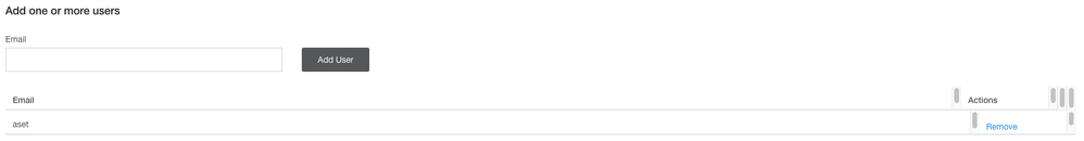

What would be the best practice to follow if I wanted to let a user delete a row of an Infotable displayed through a Collection Widget by placing a button in every cell of said widget?

I already have a service to delete rows based on an identifier. What I'm looking for is a way to update the Infotable that populates a Collection Widget through clicks on buttons located in every cell of said Collection Widget.
When you click in a cell of the collection widget, you will have a Selected Row.
You can place that in a Session Parameter and then the service that the click runs can retrieve the information from the session.
You can also just use the information that is within the cell and pass those as parameters into the service you trigger with the click.
