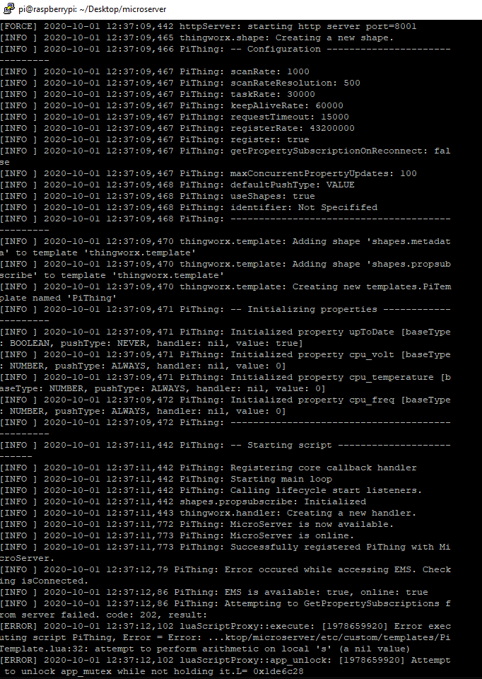

Thank you for your answer.
I used your file, i had this error :
[ERROR] 2020-10-01 12:33:38,698 luaConfigurator::initialize: Error while loading                                                                                                                                            file /home/pi/Desktop/microserver/etc/config.lua. msg: /home/pi/Desktop/microse                                                                                                                                           rver/etc/config.lua:5: malformed number near '127.0.0.1'
So i added some " ", it's going better and now i have this one :

[INFO ] 2020-10-01 12:40:31,671 PiThing: Error occured while accessing EMS. Checking isConnected.
[INFO ] 2020-10-01 12:40:31,678 PiThing: EMS is available: true, online: true
[INFO ] 2020-10-01 12:40:31,678 PiThing: Attempting to GetPropertySubscriptions from server failed. code: 202, result:
[ERROR] 2020-10-01 12:40:31,695 luaScriptProxy::execute: [1979708496] Error executing script PiThing, Error = Error: ...ktop/microserver/etc/custom/templates/PiTemplate.lua:32: attempt to perform arithmetic on local 's' (a nil value)
[ERROR] 2020-10-01 12:40:31,695 luaScriptProxy::app_unlock: [1979708496] Attempt to unlock app_mutex while not holding it.L= 0x1bd6420
Looks like there is still 2 errors, one in PiTemplate and the other one... i have no clue.
I don't know which version of EMS i'm using, and don't know where to find this info (i did search)
Thank you for your fast answer.
it's definitely better, but now i have this one :
Any idea ?

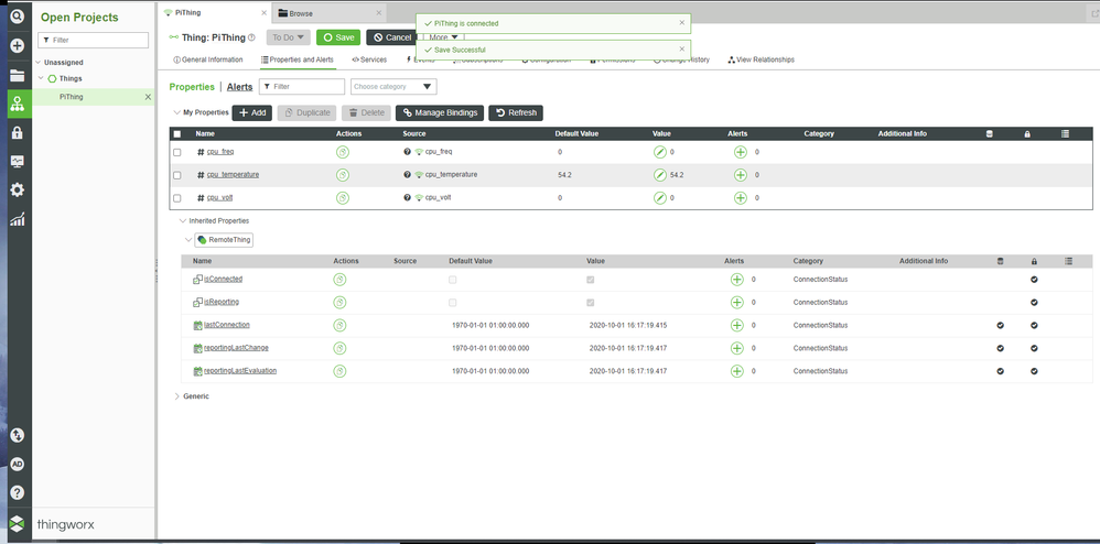

it looks like it's finally connected :
But for some reasons, only the temperature gets updated, the 2 other metrics don't move, and the temperature stay at this value at all times, can't figure why...
The Raspberry Pi 4 changed some of the system calls to get physical properties of the board. Change this line:
s = string.match(s,"frequency%(45%)=(%d+)");
To this:
s = string.match(s,"frequency%(..%)=(%d+)");
Thank a lot, that worked !!
