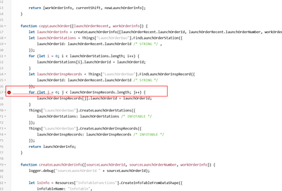

I found a very strange phenomenon,  the ES6 syntax like "let", "const" work well normally.  But in certain situation,  the Lint will report error, see the attached picture.
The line #315 and #325 define the same variable name , but it's not the root cause.  Changing to different variable name has the same error.
It seems the error occurs when the code lines exceeds about 310, but I'm sure .

If you try declaring this statement once instead of twice, does the behavior change:
  let intervalDays = interval;
Are there other errors elsewhere that may have a bearing on this one?

Hi Sharon @slangley ,
Yes, for example, the code below doesn't declare the variable "j"  twice, but still has the error.

Hi @seanccc.
I'm afraid there are a number of unknowns here since we can't see the full code.  However, we would recommend reaching out to your Sales rep or contacting the Sales team to engage with a PTC consultant for assisting with a code review.  They can recommend ways to debug and improve your code.
