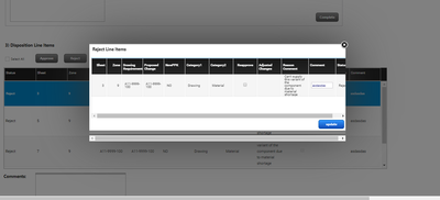

Hi everyone,
I want to passing my grid to a pop up mash up to edit some fields inside the pop up. However, the edited fields in my mashup are not saved when i exit the pop up.
Basically i passed the selected rows of my data table to a mashup via navigation widget using getdatatableentries service.
Then i run service that update the fields inside the pop up, passing editedtable as an input to that service.
I was scratching my head for last couple of days, any fresh eyes, and help will be appreciated.

Once you pass the edited datatable/update the rows, can you check in the composer if the rows actually updated?
duc_vuu
(To:posipova)
Hi Posipova,
Thanks for your response, the rows don't get updated when I run the service.
The sequence of my service:
Run getDatableEntries service to pass the selected row to the popup via navigation widget => pass the mashup parameter to the grid inside the popup => Pass the EditedTable to the RejectRow service ( bug here, the edited fields will not get updated)  => After RejectRow service finishes running run popupclosed to close the popup => popupclosed event trigger getDataTableEntries service in the main mashup (Comments and approve field inside the mashup remaining unchanged).

Or maybe my question should be, is there any way I can edit the data table inside a popup? If there is, what is the recommended way to do so?
