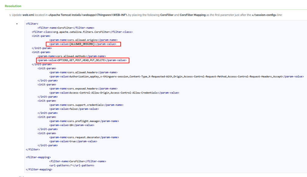

Hi @cbaurand ,
Yes, you need to make a CORS change in web.xml in the Apache Tomcat;
Below is the Article:
Article - CS229450 - How to Enable Cross-Origin Resource Sharing (CORS) in Apache Tomcat for ThingWorx Platform/ThingWorx Navigate (ptc.com)

Hi @pshashipreetham ,
Thaks for your response.
I still have a problem. I get that:
My feeling is i have to modify the content-Security_policy: frame-ancestors  in the header. Currently it is set to 'self' and i think i have to add the url that embeded my application. But i'm not able to find how to do that. In the web.xml, it seems it is not possible.
Can someone help me ?
