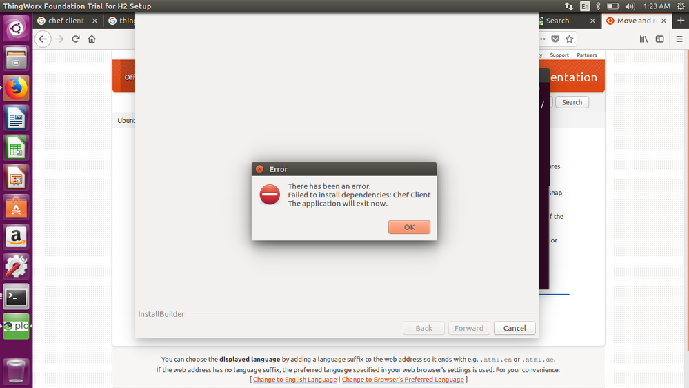

I am getting following error while installing thingworx 8.5 trial version Screenshot from 2019-11-24 01-23-21.png

We have confirmed that Ubuntu is NOT a supported platform for the trial versions.  We will be pursuing an update on the downloads page to advise this information.

What are the install logs saying?
Find them in <Thingworx_install folder>/installer/logs

No logs are getting generated at installation directory.
The error which I received is already attached as screenshot earlier.

We just updated the trials on Friday.  Are you running the latest (ThingWorx 8.5)?  Which version of Windows are you running?
Did you run the installer more than once?  If so, you will manually need to remove the artifacts that were left by the previous installation.  Also, if the installation still fails on your next attempt, search for the logs BEFORE clicking OK on the error dialog.  Once you click OK, cleanup will be performed removing the logs.

I ran the thingworx 8.5 installer only once. I am trying to install thingworx 8.5 on ubuntu 16.

I am trying to install ThingWorx 8.5 on Ubuntu 16.04 and not on Windows.

Fixing the path issue may not solve all of your problems.  We have not been able to get the 8.5 trial installer to work on Ubuntu.  We are workng to get clarification regarding support for that O/S.
