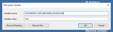

In your case I am not sure, what the exact issue is, but maybe those steps may help:
  • Make sure MSEdge is installed to the same machine thingworx runs on ...
  • Playwright tries to donwload latest versions of the Browser, which also may fail.
    You can add "PLAYWRIGHT_SKIP_BROWSER_DOWNLOAD" to your global system variables and set it to "true".atondorf_0-1720009714906.png
