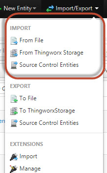

based on your login account for the hosted instance I think you should be able to import using the Import function
If in case this is not visible for you, you may want to reach out to ThingWorx Administrator to allow this for your profile.
Yes, I am able to see those options and once imported it shows imported successfully but I couldn't find the imported thing in composer.May be I miss certain steps, so could u please suggest me out with any step by step document about export and import which will be of great help.
