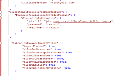

  Extensions are not importing in thingworx8.3 i have added Extension import policy in plaform setting jason file but still its throwing error. I have checked error log also in that showing related to import policy.I have deployed twice thingworx.war file and restarted tomcat also. i have attached error log file.

Make sure your ExtensionPackageImportPolicy tag should be inside PlatformSettingsConfig{} in your platform-settings.json file
placement of ExtensionPackageImportPolicy is actually causing the issue
from your screenshot seems like you have placed this ExtensionPackageImportPolicy  in PersistenceProviderPackageConfigs which is wrong i believe
ExtensionPackageImportPolicy  should be inside PlatformSettingsConfig, not outside.
Please check also this article: https://www.ptc.com/en/support/article?n=CS300115
Modify platform-settings.json to have ExtensionPackageImportPolicy inside PlatformSettingsConfig and restart Tomcat.
After this, you should be able to import extensions.
