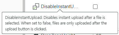

#2: The automatic upload feature is that once you have selected one or more files (or dragged them to the widget), it will automatically start the upload to the selected repository:
So basically to "avoid" uploading more than one file at a time (per user), I would have to remove the possibility of automatic upload and check if there are more than one file name in:

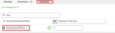

Thanks for the detailed explanation.
Set MaxNumberOfFiles value to 1
