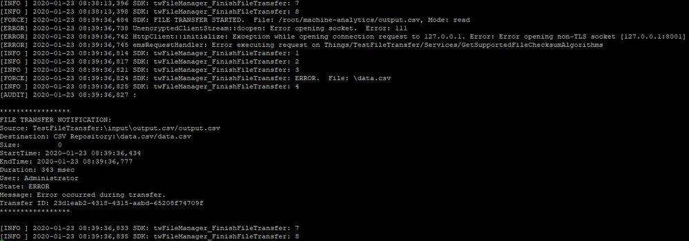

After following IoT connectivity with Thingworx course https://www.ptcu.com/course/course-view/student/117/338/1687,
When I run Copy service of FileTransferSubsystem it gives the following error.

There was a little problem.
I had to specify the port for auto_bind device in config.json and the problem has been solved.
