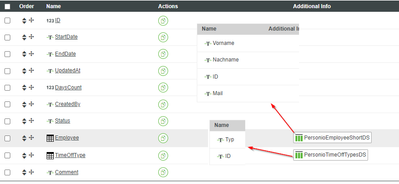

I try in vain to fill a nested infotable in a js service. The DS is defined as follows:
Now I want to fill the infotable with data using this DS. I do this as follows:

I get the following error message:
Error executing service getTimeOffTest. Message :: TypeError: Cannot read property "0" from undefined - See Script Error Log for more details.
What am I doing wrong here? Why does this not work?

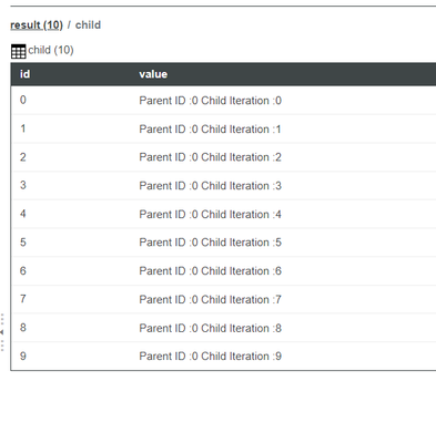

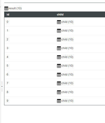

Hi @cjjaeckson
The error message means you are trying to update the value at index '0' for undefined or null infotable. You should use the "AddRow" function to add values to nested infotable
// Create Parent infotable
var parentInfoTable = Resources["InfoTableFunctions"].CreateInfoTableFromDataShape({
	infoTableName: "InfoTable",
	dataShapeName: "parentInfoTable"
// adding random value
var counter = 0;
while (counter < 10) {
	var parentEntry = new Object();
	var childCounter = 0;
	// Create child infotable
	// CreateInfoTableFromDataShape(infoTableName:STRING("InfoTable"), dataShapeName:STRING):INFOTABLE(childInfoTable)
	let childInfoTable = Resources["InfoTableFunctions"].CreateInfoTableFromDataShape({
		dataShapeName: "childInfoTable"
	while (childCounter < 10) {
		var childEntry = new Object();
		childEntry.id = childCounter;
		childEntry.value = "Parent ID :" + counter + " Child Iteration :" + childCounter;
		childInfoTable.AddRow(childEntry);
		childCounter++;
	parentEntry.id = counter;
	parentEntry.child = childInfoTable; // Nested InfoTable value
	parentInfoTable.AddRow(parentEntry);
	counter++;
var result = parentInfoTable;
You will have output like this
Nested infotable value
/VR
