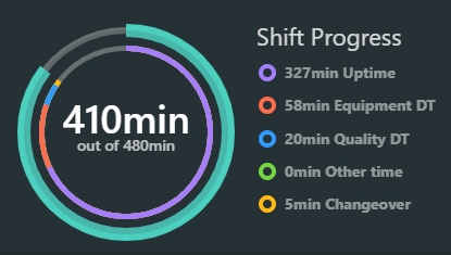

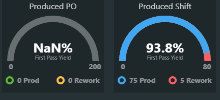

I wanted the gauge that I have attached as pictures. Will I be able to get it from marketplace?
I already have used progress gauge and normal gauge widget in my Mashup but it doesnt meet my requirement.
I am not getting the half gauge.
By any chance can i modify the existing gauge that I have into this kind or any extensions available?
Please provide some help.

The ProcessGauge is available on the Marketplace
https://marketplace.ptc.com/apps/193072/progress-gauge#!overview
Using Reference Angles, Apertures, RingWidth etc. allows you to customize it.
You could use this as a basis for the Gauge and overlay it with various labels to display the information in a different place etc - or customize the Widget further.

I have already downloaded the progress gauge but even when I changes reference angle and all those I was not able to get the accurate one in the picture especially the half gauge one. Do you have any idea on this?

The half gauge needs a ReferenceAngle of 270 and an Aperture of 180
To get gauges that look exactly like in your reference pictures, you will either need to use additional labels for displaying the additional information - or alternatively customize the Process Gauge Widget to show additional numbers and legends.
As the ProcessGauge is handling one value, it would also need to be customized to display further values in various color schemes.
