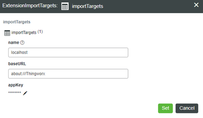

When trying to export data project trough the mashup GitBackup.Main.Mashup the export button keeps loading and I get no answer.
I tried executing the service ExportProjectData directly but I get the following message
"Error executing service ExportProjectData. Message :: unknown protocol: about - See Script Error Log for more details"
I checked the ScriptLog but the message is almost the same as above, giving no further detail on how to troubleshoot.
Any suggestions?

Hi @nahuel ,
I will assume you are speaking about version 3.0.1.
There is a hint in the message: it complains that the protocol it tried to use is "about:". I'm thinking that the URL autodetect mechanism failed, and we need to understand why.
I am listing a series of actions and questions that you should do:
1. Open the Things["ExtensionImportTargets"] and check if the property "importTargets" contains a) a single row and b) a value similar with "https://192.168.91.140:8443/Thingworx "
2. If you can (it requires access to the logs folder in the ThingworxStorage folder) check the "ScriptErrorLog.log" file and find the line number where the error occured. Hint: The error message should be the same as the one in the ScriptLog and it should have the line number at the end.

By Default it is set as below. Need to change baseURL as per your comment.
