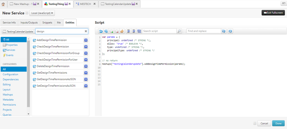

Hi eengelbrecht,
Thanks for your response.
As you suggested I called a generic service from Entities tab to add design time permission to a mashup. But it doesnt show me any space to add the user. Should I give the username in Principal row?
var params = {
principal: undefined /* STRING */,
allow: 'true' /* BOOLEAN */,
type: undefined /* STRING */,
principalType: undefined /* STRING */
// no return
Mashups["TestingCalendarUpdate"].AddDesignTimePermission(params);
@svisveswaraiya
Principal here should be user
like in my snippet example i am defining the design time (Update) permissions for userA
this is the way it worked.
and if you are defining permissions at Group level then it should be like
principal : "testgroup"
principalType:"Group"
I believe this will help and if it does then mark this as solution for the beneficial for others
var params = {
principal: "userA" /* STRING */,
allow: true /* BOOLEAN */,
type: "Update" /* STRING */,
principalType: "User" /* STRING */
// no return
Mashups["keyboardEvent"].AddDesignTimePermission(params);
