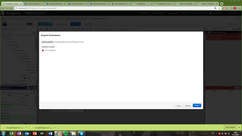

Im sorry i have tried to solve the problem. Got now a key but i used the google map extension pack 3.0.2. When i open the meta.xml file there is specialy now url inside anymore to edit. I try to copy the file inside and zip it again but i get all the time the sam error. Any idea ? Thank you in advance

Thanks Sharon, taking care of me i need it for a project at school. Anyway just when i open the zp package of the 3.0.2 version. At the moment im using the thingworx version ThingWorx 8.3.2-b535. And want to add the google maps extension.
this is the rrorthis is the rror
So my plan was to add the API Code to the 3.0.2 version and zip it again, but then it shows me that error. Im now certainly not sure if i zip it maybe again wrong, or the url code is wrong. Thank you a lot
First one is the 3.0. version id like to add there my API inside but the Url is missing so i did it as it is in the further one.
this is the further one as you can see the API URL
