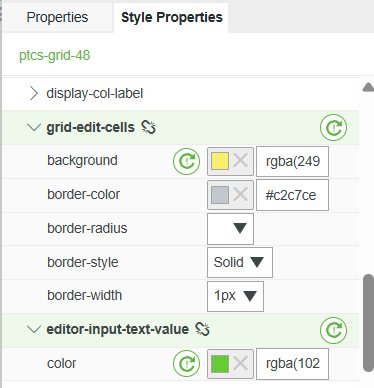

Apart from configuring styles through Style Properties UI, I didn't find a good way to apply styles to grid edit popup through custom css.
Based on my limited tests, it appears that the popup content and the style are rendered with JS at runtime and will override the style defined in custom css.
I guess you need to raise an enhancement idea in community to have the font family attribute exposed for grid-edit-cells in Style Properties with certain fonts available as per your requirements (or allow typing instead of selecting from drop down)

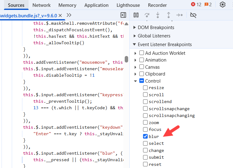

For inspecting the ptcs-grid-edit-cells element, you can go to sources tab in the DevTool and add an event listener breakpoints (control - blur)
*The blur event fires when an element has lost focus
Click resume script execution until the popup appears
Go back to elements tab to inspect the popup the same as you would for other elements (The popup will not disappear as it is paused in debugger)

With the help of Event Listener Breakpoints, I could find the class and part details and able to apply external fonts. Thank you
