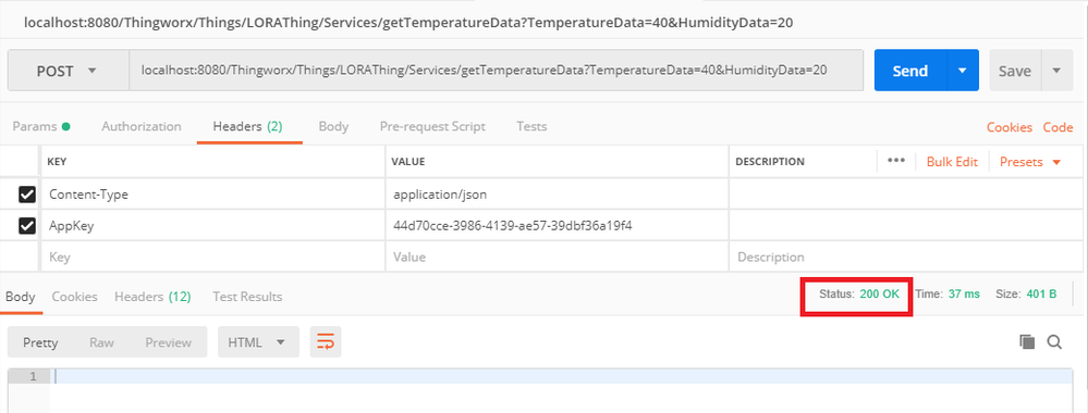

I am not able to establish an HTTP integration from The Thing Network to ThingWorx and therefore not able to view the data coming from The Thing Network in ThingWorx mashup. Though when I am hitting the url via postman, I am able to see the changes in mashup.

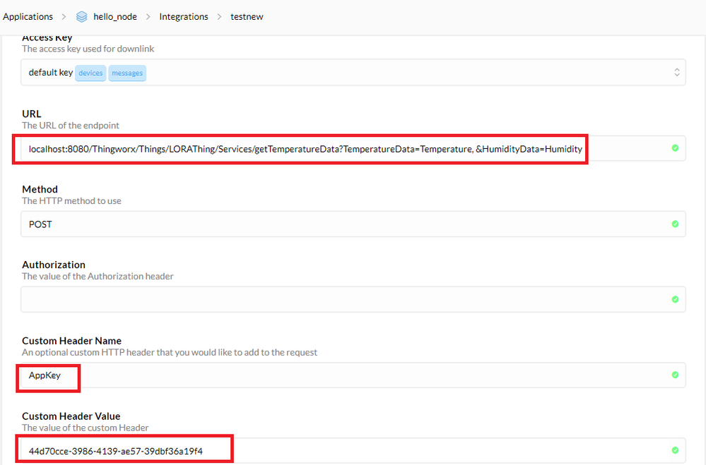

I am trying to hit the highlighted URL in The Things Network and it is not giving any response or maybe not getting hit. However, when I try to hit from postman, it is getting hit.
Can you help me on how to do so? I would even appreciate if we can have a call.

Hi @Vikram.
I would try testing from the local machine and see if it works that way.  If it does, move to another machine on the network and test it.  If this fails, I would then try turning off your ThingWorx server firewall to see if it works that way.  If it does, you can turn the server firewall back on and add a port exception to allow the traffic through.   Continue testing in this manner until you identify where the blocking is occurring.
It's also a good idea to check the logs at \ThingworxStorage\logs each time your testing fails in order to determine more regarding the failure:  Is it hitting the server and failing or is it not hitting the server?
