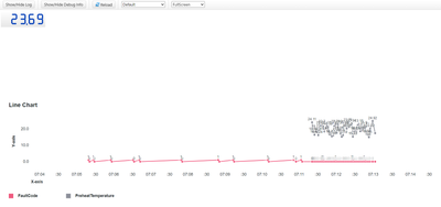

I'm getting all properties from a Thing in a mashup.
How I can get rid of one of them (FaultCode for example)?

One way you could do this would be to create your own service and filter out your data in there.

I have accomplished following your suggestion and works,,,, but I suspect that should be a shorter way.......
var modelProperties = Resources['InfoTableFunctions'].CreateInfoTable({infoTavleName: "modelProperties"});
modelProperties.AddField({name: "name", baseType: "STRING"});
modelProperties.AddField({name: "description", baseType: "STRING"});
modelProperties.AddRow({name: "PreheatTemperature"});
var data = me.QueryNamedPropertyHistory({
    propertyNames: modelProperties,
    maxItems: 1000
result = data.ToJSON();
or this one:
let data = me.QueryNumberPropertyHistory({
"propertyName": "PreheatTemperature"
data.RemoveField("id");
