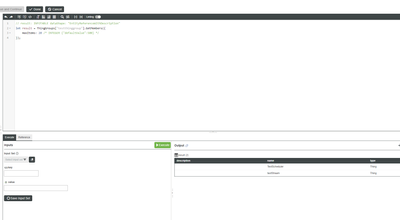

Hi @ParthBhadiyadra
You can use 'GetMembers' service to get Thing Name from Thing Group
/VR

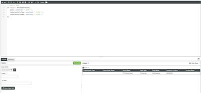

Hi @ParthBhadiyadra
I don't know if there is any direct way to get Thing Group from the Thing level
As a workaround, you can use the 'GetWhereUsed' service to get a thing relationship with any Thing Group
You can further filter this InfoTable based on EntityType  to get ThingGroups details alone
