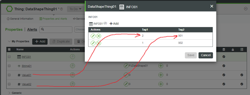

I created tag INFOTABLE for doing pie chart.
by Column Tag1 is data, Column Tag2 is Name of data
I want to bring Value01 link with Column Tag1 and Row 1,Value02 link with Column Tag2 and Row 1
I tried the test using only 2 data for test data transfer Value01 and Value02 to INFO01
I tried to do it using Service script but not yet finished.
Would you advice what I could do?
Thank you
Theeradaech
