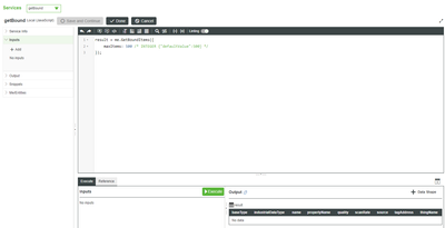

Is it possible to get a list of all bound properties and their source and VTQ on a Thing by executing a service? Ideally I would like to monitor bad endpoints and create some notification to help track and fix any problems.
I have tried the getBound Items function with no success, even though I have quite a number of properties bound on my thing.
