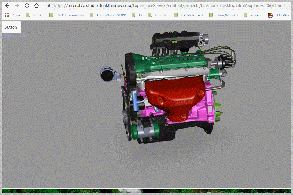

This is option is applicable on windows plattform where the vuforia studio is installed. It used the preview mode. The option is described in PTC article:
It that possible to embed ThingWorx view app main function into a webpage
So the effect is the following - see picture above so  that it could be called  form a link in a Thingworx mashup (unfortunately this will not work inside a Web Frame widget) and it calls the preview from the Experience Service.

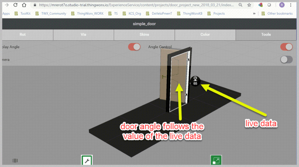

This also will display the live data! Here below an other example:

I am not sure  if this option could be possible solution  for you but just for the case I want to metion it here.
