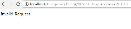

now result is showing like pictures
and i test API following URL
but REST API return invalid request
request API URL isn't wrong?
It returns the ThingWorx service definition instead of JSON when attempting with the following URL:
