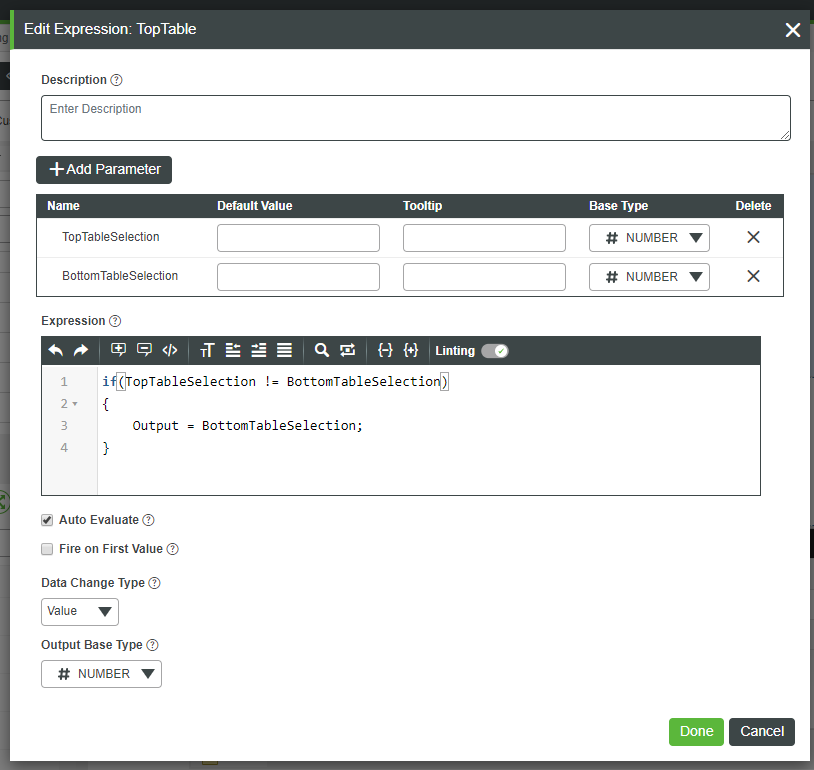

The ThingWorx Utilties Extension contains the InfoTableSelector widget. It is an invisible widget that takes an input of an infoTable and allows you extra functionality such as events to clear a row selection (useful for dropdowns), booleans to let you know if data is or is not selected, and (for this solution) a number property with inputs/outputs that represents the index of the row selected/row to select.

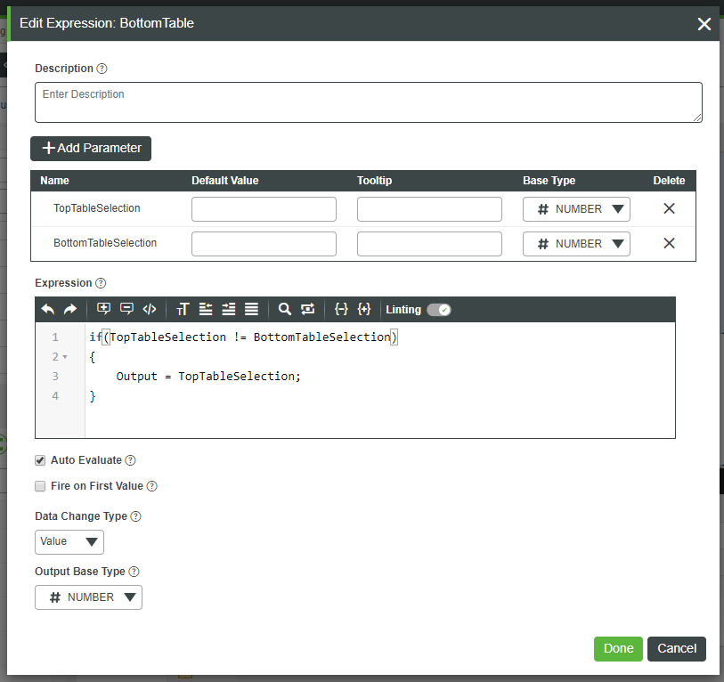

You would need to place two instances of the InfoTableSelector widget in your mashup, one for your table data and one for your chart data. You would then need to create two Expression functions (expression widget in ThingWorx versions earlier than 8.4). The Expressions will be set up like the images below:
The inputs to these Expressions will be the InfoTableSelector property SelectRowNumber from both InfoTableSelectors. The number output of the Expressions will be bound back to the opposite InfoTableSelector SelectRowNumber property.
In my example, my Expression TopTable represents my chart and its selection. The TopTableSelection is the SelectRowNumber from my chart, the BottomTableSelection is the SelectRowNumber from my table. If the values do not match, because this Expression is for my chart, I want the value of the BottomTableSelection and want to bind the number output to the InfoTableSelector property SelectRowNumber of my chart.
This seems to work in my testing and I hope my explanation wasn't too confusing.
-Andrew
