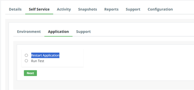

Are there any Thingworx Extension developers out there who do not have direct access to there Thingworx (non-prod) server?
Our servers are hosted by the PTC Cloud team, so we do not have direct access to the backend.
It is not uncommon to be prompted to restart the Thingworx server when trying to import an extension.
Cloud Direct offers "Self-Service" features, one being Restart Application. This would be a great feature for this issue, if it worked for all environments.
Currently none of the Self-Service features work for our development environment (I am not sure if this affects other Cloud Direct users).  We have a case open about this issue and until it is resolved we have to open a new case for each server restart.
I am curious how other TWX Extension developers handle restarting their TWX dev environments.
TIA for sharing!

As far as I know, as a cloud customer you are entitled to run local dev environments as well, and that is what I would do - create a local instance, either on-prem or directly on your machine. Then you can decide if you want to restart the whole tomcat or just the Thingworx App via Tomcat Web Application Manager.
