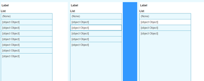

Hello everyone,
I have a service that returns an infotable with a column that contains multiple rows with infotables.
I want to use a collection widget to display the nested infotables dynamically (depending on how many rows there are).
The user is supposed to select something in one of the infotables. This selection, I want to use!

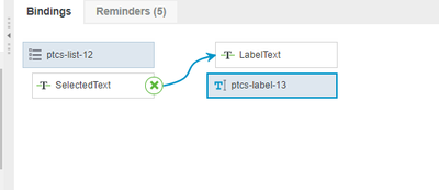

This were the bindings I created. But in the label which should display the selection data, nothing is displayed. Is this a bug or am I doing something wrong?
Note: please disregard [object object], I have set DisplayField, StateField, ValueField but for privacy reasons I took the screenshot before I set it.
I would appreciate any help!
Thank you!

@HD_10225728 : To the label, can you please try binding the SelectedText property of the list?
