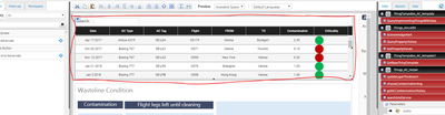

Hello community.
I would like to have a progress bar as a column in a grid widget based on a percentage value from 0-100, how can I do that?
I am aware that progress bars could be done by a shape widget, so perhaps it could be possible to have a column as a shape that can take a value?
The goal is to have the grid look like this:
Thank you in advance!

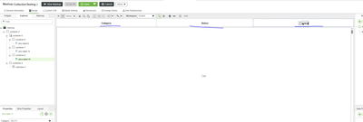

1. Create a ParentMashup and place header label and collection widget

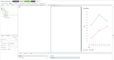

2. Create ChildMashup for collection widget with Label and Shape Widget
Note: DO NOT CALL ANY SERVICE OR CREATE ANY FUNCTION IN CHILD MASHUP.  (Which will affect the performance of the app )
3. Create Mashup Parameters in ChildMashup. Mashup Parameters will pass data from ParentMashup to ChildMashup

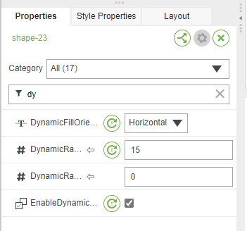

4. Bind Mashup Parameters to Shape Widget and Label
5. Enable Dynamic filling in Shape Widget and Set Dynamic filling maximum limit

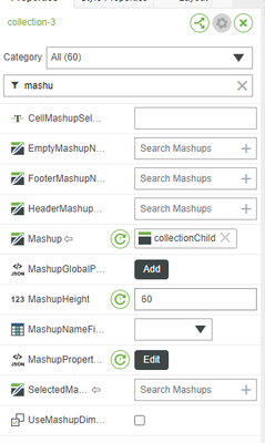

6. In parent Mashup, pass data to the collection widget from your service
7. Set Mashup property value as your childMashup which you created in step 2
8. Set UID Field which should be unique for each row. In my example I have set rowNumber as UIDField which is unique for each row
9. Configure Mashup Parameter JSON to pass data from service to childMashup
In Mashup Parameter JSON, the key should be dataFieldName from Service and the value should be Child Mashup Parameter name
10. Set Mashup height to 60px (each row height) and View Type to Table in the Collection Widget property
The result should look like this :
I have attached example entities for your reference.
/VR

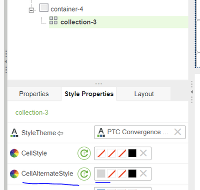

Hi @Velkumar
As you can see in the image below, the collection widget table here has no styling, no cell colors, no borders, etc.
I want to make it look more like a table, preferably something similar to the image below:
I tried to edit the Style properties, but it made no difference:
Is there a way to style the collection widget to make it look more like the table above?
Thank you.
Hi @S_Elsayed
Please follow the below steps :
1. Remove the background color for all containers in the child mashup
2. Add border to top-level container in child mashup
3. Set alternate style definition in collection widget style property
It should look like this :
