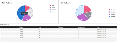

Thank you so much @Arun_C  for your reply it is working fine now I do have another doubt if you can, please help me in this
I have a doubt I am attaching file for detailed understanding
I want to use pie chart and in that I want to configure it a way so that whenever I select any section of that pie chart It should render to the source it may be another pie chart or may be a grid data associated with that particular section similarly other section as well Now for that please tell us how can I proceed please also write the service as well for the data I have given it in the attached Image.
Best Regards,
Rayon
Hi @Rayon_11 ,
Based on my understanding I have created & attached your use case in demo entities. Kindly import the attachment in order (Datashapes, Thing & Mashup) and view the mashup of "PTC.Community.PieChart.MU" . It may clears your doubts.
Runtime:
If any queries please let me know.
Thanks & Regards,
Arun C
