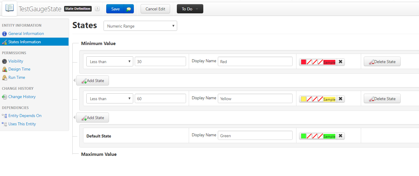

I am using Progress Gauge widget to show some data. My requirement is to change the color of Progress gauge widget when value changes, for example I want color "Red" for 0 to 30 , color "yellow" for 31 to 60 etc.
I am using ThingWorx 8.2.

Greetings @ras,
To fulfill you requirement, please follow the below steps:
1) Create a State definition and define the States information in it as per your requirement. Refer screenshot for reference.
2) Apply the State Definition to the Gauge by changing the property named 'ValueFormatter'

ras
(To:hchanana)
Thanks @hchanana
I am using a Progress Gauge (downloaded the extension from marketplace). I wanted to display a color gradient in the gauge as the value progresses. I have added the state definition to the 'ProgressFormatter' property but it doesn't seem to work. Am I missing something. Kindly help.
