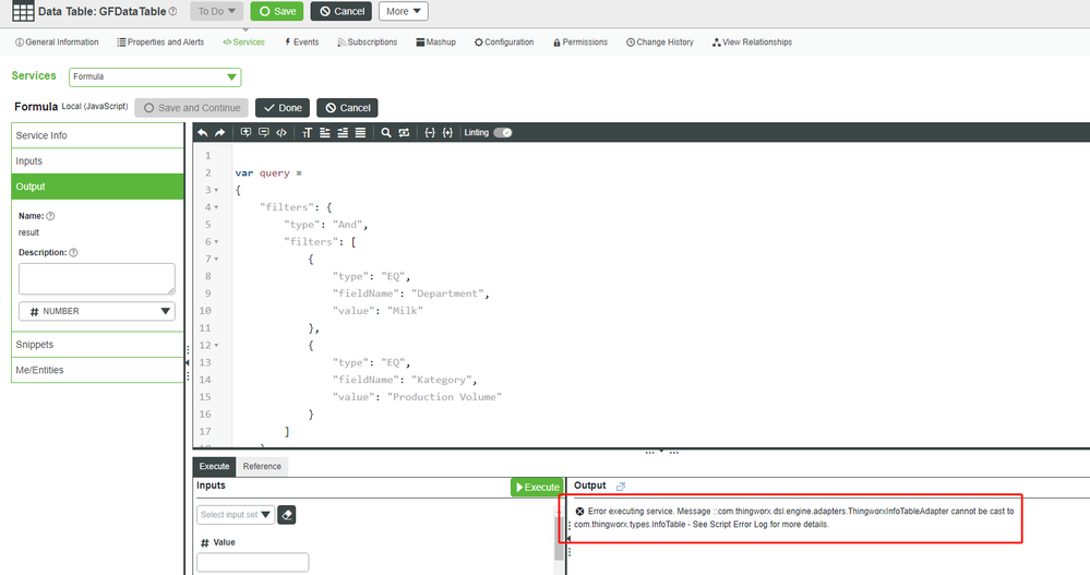

Re: How to convert datatable's data into Number
var output = Resources["InfoTableFunctions"].RenameField({
t: Resources["InfoTableFunctions"].Aggregate({
t: me.QueryDataTableEntries({ maxItems: undefined,
query: query,
values:undefined,
source: undefined,
tags:undefined
columns: 'value',
aggregates: 'SUM',
groupByColumns: 'value'
from: "SUM_value",
to: "value"
var result = parseInt(output);
 here is my code and output should be number but now is NaN. Please take a look and give me suggestion how to edit

Hello @xiaoqw ,
RenameField returns an INFOTABLE and not an INTEGER, so you probably want to do something like this:
var result = parseInt(output.value);
// or
var result = parseInt(output.rows[0].value);
/ Constantine
