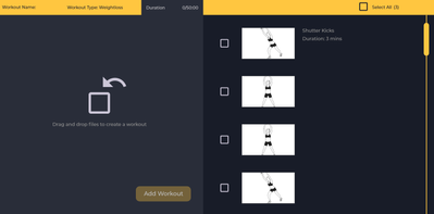

I want to make a drag n drop mashup which having workout video data which is in the collection list and want to drag that each data into left side container so that i have to make data list of video of workout.
See the above image i want to make the mashup same.
